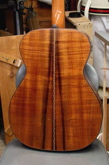

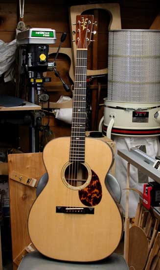

Well, I've finally finished the koa 000 I started back in January. It's the second one completed (third start), but it took longer than #1. I'm quite happy with it, though. I read everything I could find here and around the web by Alan Carruth about Chladni patterns. Thank you Alan!! The resonant frequency of the x-braced back is about a semi-tone above the top, with both plates glued onto the rim and the bridge on. Nice fat range of tones, this one. Much fuller in the lower pitches. Koa and Lutz from BobC, Mad rose bindings with black fiber/maple purflings, 24.9 scale, CF neck bars. Lots of fundamental. French polish without oil; my walnut oil wasn't drying and I never got around to getting another batch.
A debt of gratitude to the OLF!!

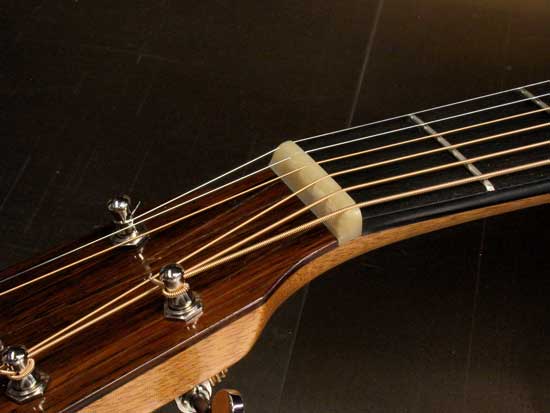

I'd forgotten how tricky the vintage Martin style nuts are.

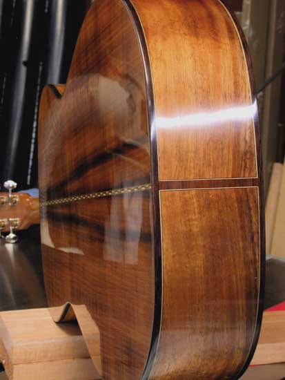

...Nice FP execution...how difficult to do without oil
...Mitred purfs...always an indicator of attention to detail, patience and skill.

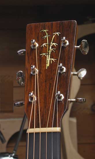

...Headstock inlay...what material did you use...I like it a lot.

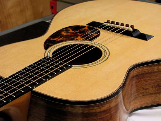

Very very nice guitar Pat . Love the french polish . The pick guard really suits too.

Especially nice peghead inlay.

Great looking guitar, Pat! Really nice design, perfect selection of materials, and one of the coolest inlays I've seen in quite a while!
